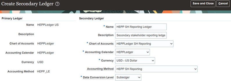

Set up a stakeholder reporting ledger as a secondary ledger.
Note: For this configuration, you must also make sure the accounting options in the Joint Ventures subledger and your other subledgers are set up correctly. You can find the details after the following example.
Refer to the example in the following image when setting up your stakeholder reporting ledger. It shows the Create Secondary Ledger application with an example of a stakeholder reporting ledger named HEPP SH Reporting Ledger. This stakeholder reporting ledger will be used for stakeholder reporting of transactions in the primary ledger HEPPLedger.
This image shows the Create Secondary Ledger application with an example of a stakeholder reporting ledger named HEPP SH Reporting Ledger, the details of which are described in surrounding text.
Make sure to set up your stakeholder reporting ledger as described here.
  • You must select the chart of accounts that you set up for the stakeholder reporting ledger, which has the additional segment for the stakeholder.
  • Make sure that the accounting calendar and the currency for the secondary ledger are the same as the ledger you’re setting up the secondary ledger for, which in this example is the primary ledger.
  • Select the accounting method that you set up for stakeholder reporting.
  • For the Data Conversion Level, select Subledger.

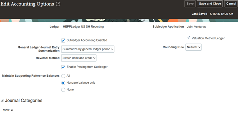

Access the Manage Subledger Accounting Options application from the Joint Venture Management functional area. Verify these settings are enabled for the Joint Venture subledger as shown in the following image:
  • Subledger Accounting Enabled
  • Valuation Method Ledger
  • Enable Posting from Subledger
This image shows the Edit Accounting Options application with the settings enabled for the Joint Venture subledger, which are described in surrounding text.

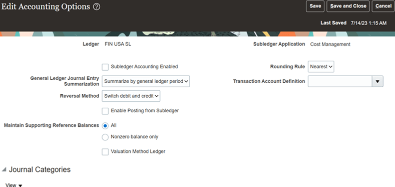

For the other subledger applications, make sure the following accounting options are not enabled as shown in the example of the Cost Management subledger in the following image:
This image shows the Edit Accounting Options application with the settings enabled for the Cost Management subledger application. The pertinent settings depicted in the image are described in surrounding text.
