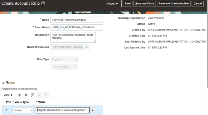

The following image shows an account rule named HEPP SH Reporting Company that’s set up to define the source for segment HEPPCompany in a stakeholder reporting COA. The account rule header area includes these values to identify the segment:
  • Chart of Accounts = HEPPLedger SH Reporting
  • Rule Type = Segment
  • “Segment value” = HEPPCompany
In the Rules section, these values define the source for the segment:
  • Value Type = Source
  • Value = Original Transaction GL Account Segment 1
    This is the source that represents the Company segment in the primary ledger.
This image shows an account rule named HEPP SH Reporting Company that’s set up to define the source for segment HEPPCompany in a stakeholder reporting COA. The details of the account rule are described in surrounding text.

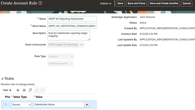

The following image shows an example of an account rule name HEPP SH Reporting Stakeholder that’s set up to define the source for the stakeholder segment in a stakeholder reporting COA. The account rule header area includes these values to identify the segment:
  • “Segment value” = HEPPStakeholder
In the Rules section, these values define the source for the HEPPStakeholder segment:
  • Value = Stakeholder Name
    You can also select Stakeholder ID for this value.
This image shows an example of an account rule name HEPP SH Reporting Stakeholder that’s set up to define the source for the stakeholder segment in a stakeholder reporting COA. The details of the account rule are described in surrounding text.

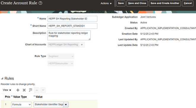

If the value set for the stakeholder segment is Stakeholder ID, instead of creating the preceding account rule, you need to create an account rule for the stakeholder segment using the predefined Stakeholder Identifier Segment formula. This account rule is required to convert the stakeholder IDs to text.
The following image shows an example of an account rule named HEPP SH Reporting Stakeholder ID. The Rules section contains a record with a Formula value type and Stakeholder Identifier Segment is selected for the value.
This image shows an example of an account rule named HEPP SH Reporting Stakeholder ID, the details of which are described in surrounding text.

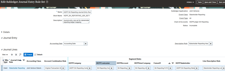

Create a copy of the predefined Stakeholder Reporting Books journal entry rule set and configure it with the account rules you created.
To access the journal entry rule set, in Setup and Maintenance, select the Joint Venture Management functional area and then select the Manage Subledger Journal Entry Rule Sets task.
The following image shows an example of a copy of the predefined journal entry rule set named HEPP Stakeholder Reporting Books. Remember the following details as you set up your journal entry rule set:
  • Associate the chart of accounts for the stakeholder reporting ledger with the journal entry rule set.
  • In the Stakeholder Reporting journal line rule, in the Segment Rules section, select the account rule that you set up as the source for each segment.
    Note: The Stakeholder Reporting journal line rule is predefined and is set up with the debit line type by default.
This image shows an example of a copy of the predefined journal entry rule set named HEPP Stakeholder Reporting Books, the details of which are described in surrounding text.
Also, you can click the predefined Stakeholder Reporting journal line rule to view the following default settings:

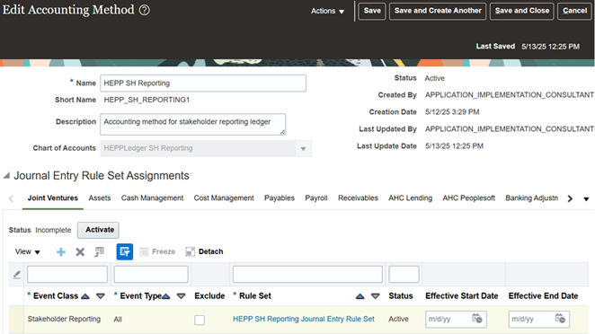

Access the accounting method that you set up for stakeholder reporting and assign the journal entry rule set to it.
The following image shows an example of an accounting method named HEPP SH Reporting in the Accounting Method application. It’s associated with the chart of accounts for the stakeholder reporting ledger. The Journal Entry Rule Set Assignments area includes a record with the following fields and values to assign the journal entry rule set to the accounting method:
  • Event Class = Stakeholder Reporting (predefined value)
  • Event Type = All
  • Rule Set = HEPP SH Reporting Journal Entry Rule Set
This image shows an example of an accounting method named HEPP SH Reporting in the Accounting Method application, the details of which are described in surrounding text.
