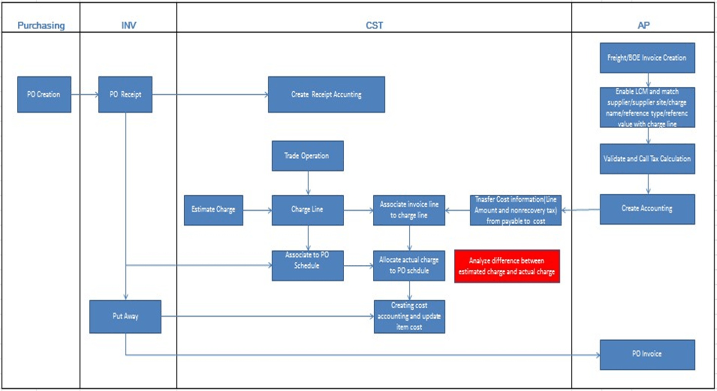

This image displays the work flow for this case study.
