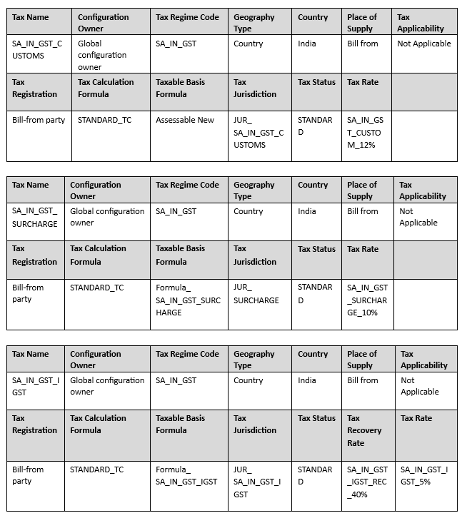

Create three taxes as follows:
This image shows the taxes to be created and their details:

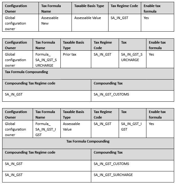

Click Add and create Taxable Basis Formulas with these attributes.
Enter these values to create tax formula:
