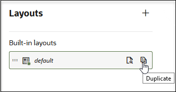

  5. In the Built-in layouts area, hover in the default layout, and select the Duplicate button.
    The Duplicate Layout UI.
  6. In the Duplicate Layout dialog box, enter a name for the layout and click Duplicate.
