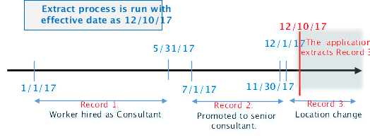

Scenario 1
When you run the extract process with effective date as 10-Dec-2017, the application extracts Record 3.
This figure shows which record is extracted when the extract process is run with effective date as 10-Dec-17:

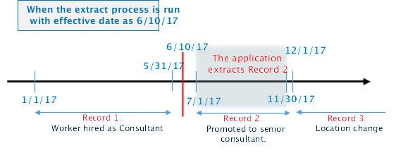

Scenario 2
When you run the extract process with effective date as 10-June-2017, the application extracts Record 2.
This figure shows which record is extracted when the extract process is run with effective date as 10-June-17:
