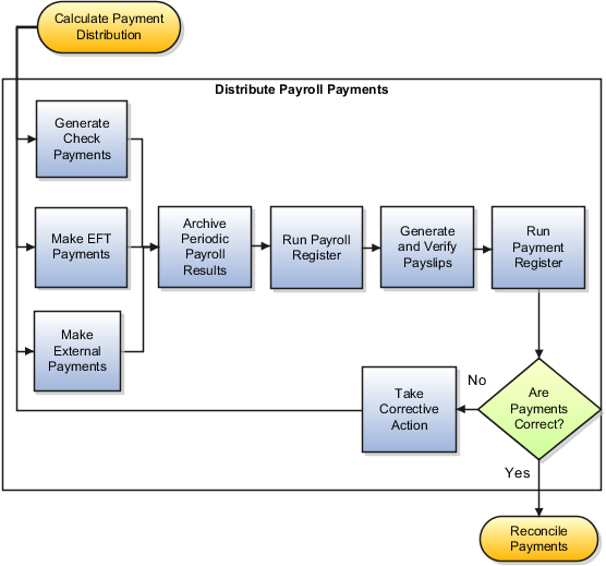

Sequence of Tasks
This shows the sequence of payment distribution tasks for a typical payroll cycle. Your flow could include additional or fewer tasks.
The Archive Payroll Results runs before Run Payroll Register and Generate Payslips.
Overview of the Payment Distribution Tasks
This table describes the payment distribution tasks.
