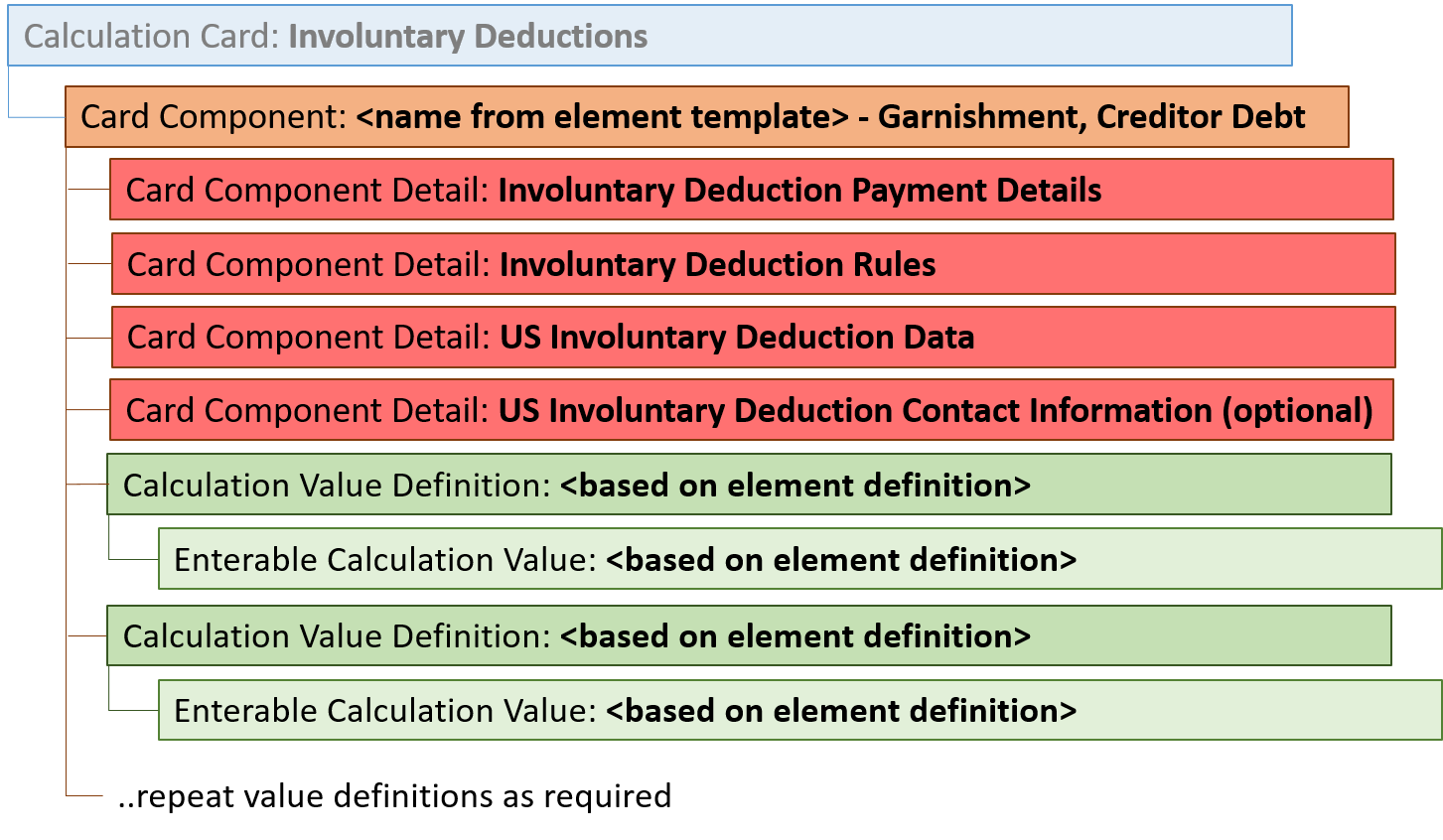

Calculation Card
Always supply the CalculationCard record for the Involuntary Deduction, even if the calculation card already exists for the employee.

Card Component
Define the type of Involuntary Deduction using the CardComponent record type.

Component Details
Use the ComponentDetail record type to provide flexfield segment values. This example supplies a subset of the flexfield segments available.

Value Definitions
Use the CalculationValueDefinition and EnterableValueDefinition record types to provide override values for the value definitions.
