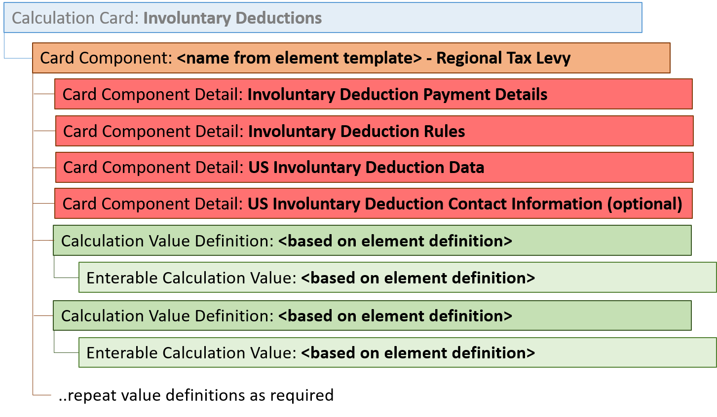

The example file lines in the section below are always supplied together in the same CalculationCard.dat file.
Calculation Card
Always supply the CalculationCard record for the Involuntary Deduction, even if the calculation card already exists for the employee.

Card Component
Define the type of Involuntary Deduction using the CardComponent record type.

The parent Involuntary Deduction Calculation Card is identified by the DirCardId(SourceSystemId) attribute which has a value that match the SourceSystemId attribute on the CalculationCard record.
Component Details
Use the ComponentDetail record type to provide flexfield segment values. This example supplies a subset of the flexfield segments available.

The parent Card Component is identified on the ComponentDetails records by the DirCardCompId(SourceSystemId) attribute, which has a value that matches the SourceSystemId on the CardComponent record.
Value Definitions
Use the CalculationValueDefinition and EnterableValueDefinition record types to provide override values for the value definitions.

The parent Card Component is identified on the CalculationValueDefinitions records by the SourceId(SourceSystemId) attribute which has a value that matches the SourceSystemId on the CardComponent record.
The parent for each Calculation Value Definition is identified on each EnterableCalculationValue record using the ValueDefnId(SourceSystemId) attribute, which has a value that matches the SourceSystemID attribute on the parent CalculationValueDefinition record.
