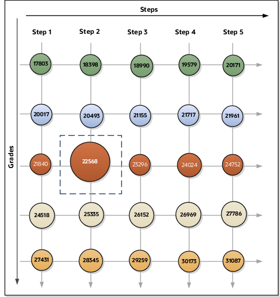

Using HCM Data Loader, set up five different grades and add five steps for each grade.
As shown in this illustration, set up grades 1 to 5. And add the five grade steps, Steps 1 through Step 5, to each of the grades.

Result: As shown in this illustration, the application returns a rate value of 22568.
