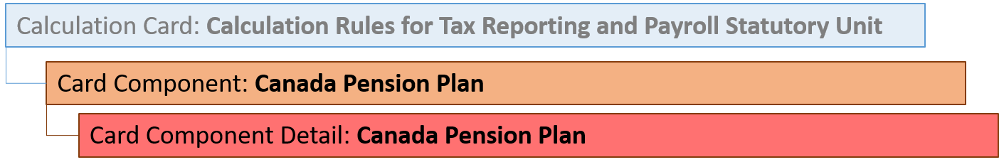

Canada Pension Plan Card Component Hierarchy
The Canada Pension Plan card component has this shape:
The Canada Pension Plan card component uses the Canada Pension Plan flexfield context and data for this is loaded using the Component Detail record type.
