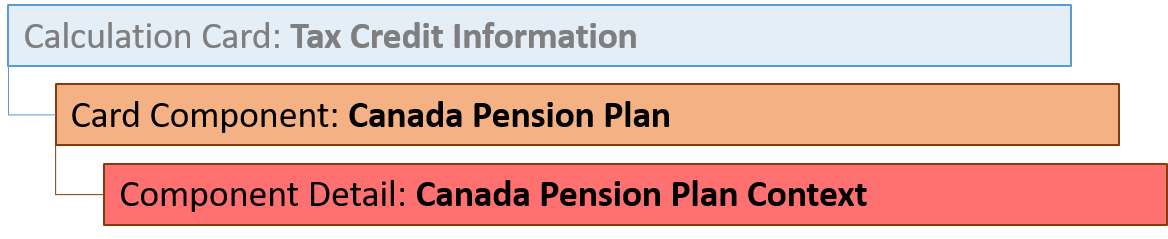

Canada Pension Plan Card Component Hierarchy
The Canada Pension Plan card component utilizes the Canada Pension Plan Context flexfield context and data for this is loaded using the Component Detail record type. The following sections describe how to supply valid file lines for these record types.
