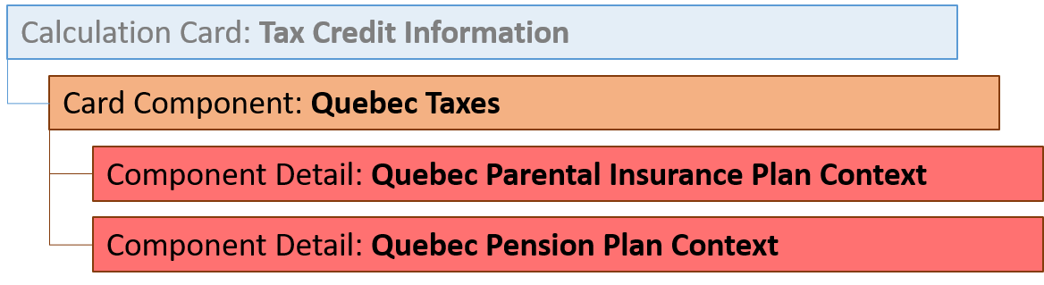

Quebec Taxes Card Component Hierarchy
The Quebec Taxes card component utilizes two flexfield contexts and data for these are loaded using the Component Detail record type. The following sections describe how to supply valid file lines for these record types.
