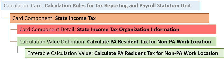

State Income Tax Card Component Hierarchy
The State Income Tax card component has this shape:
The State Income Tax card component uses the State Income Tax Organization Information flexfield context and data for this is loaded using the Component Detail record type. For the state of Pennsylvania you can also provide an override for the Calculate PA Resident Tax for Non-PA Work Location value definition, this is loaded using the Calculation Value Definition and Enterable Calculation Value record types.
