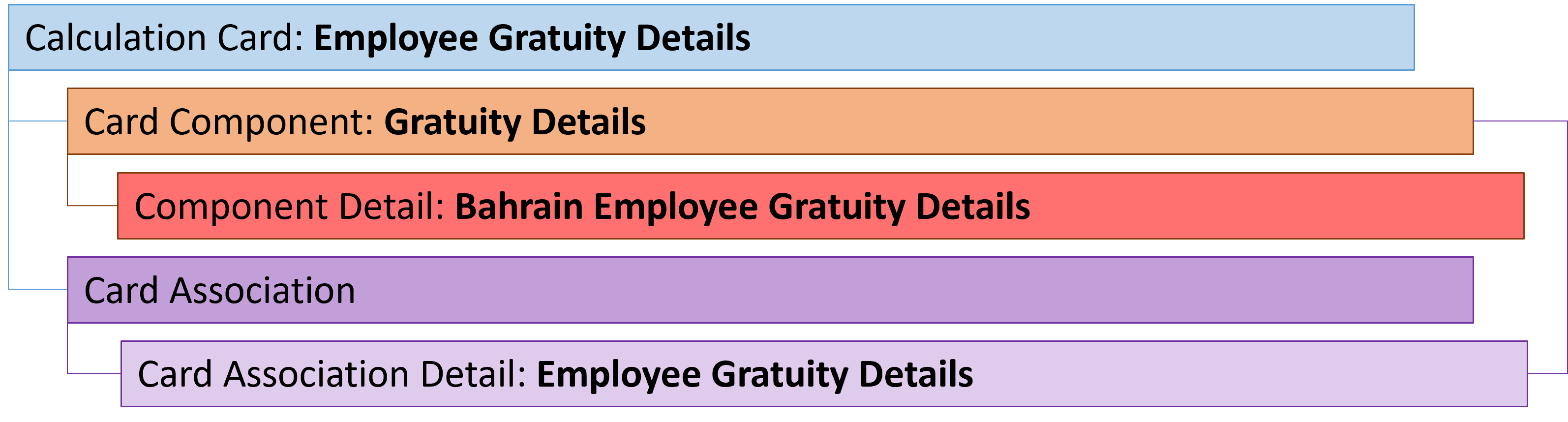

Employee Gratuity Details Calculation Card Hierarchy
The hierarchy of calculation card components applicable to Employee Gratuity Details are described in this diagram:
