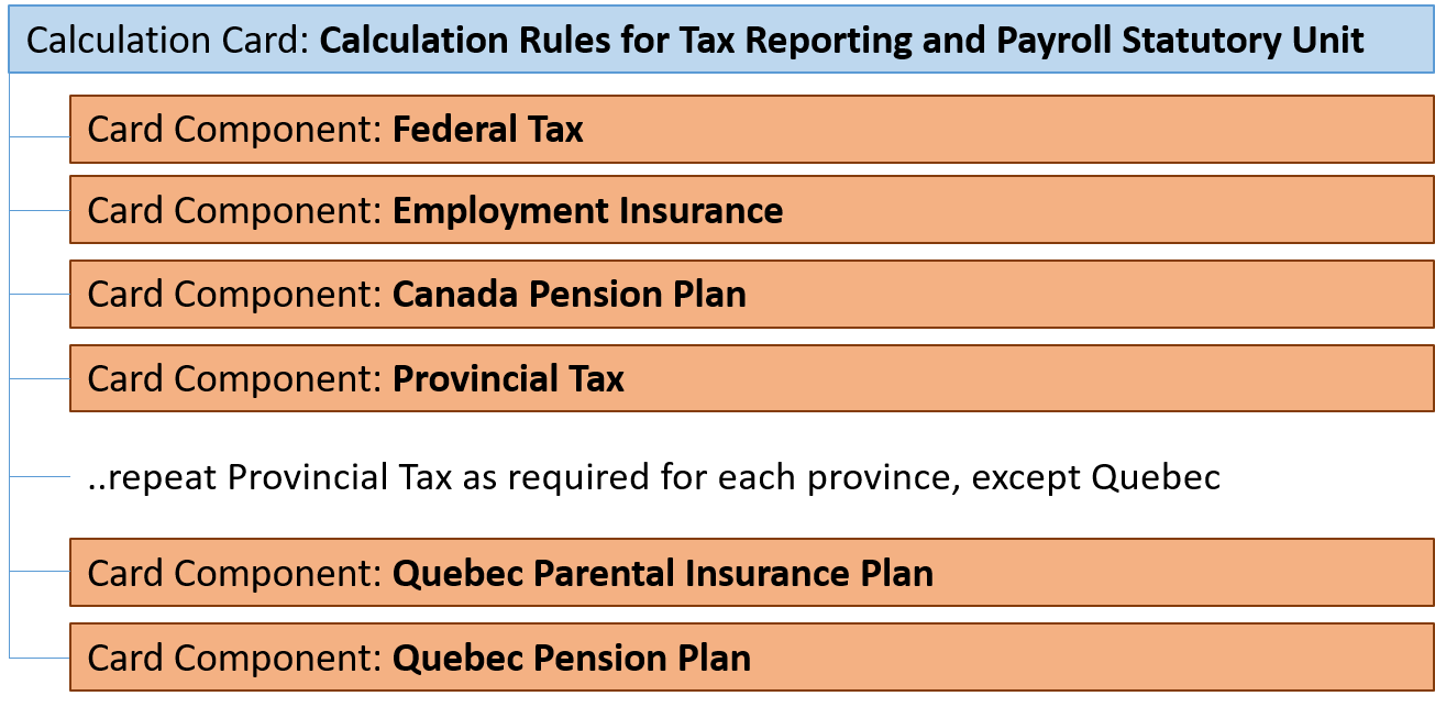

Calculation Rules for Tax Reporting and Payroll Statutory Unit Hierarchy
The Provincial Tax card component is repeated for each province, except Quebec, which uses the Quebec Parental Insurance Plan and Quebec Pension Plan card components instead.
The details of how to load data for each of these card components are found in the other related topics.
