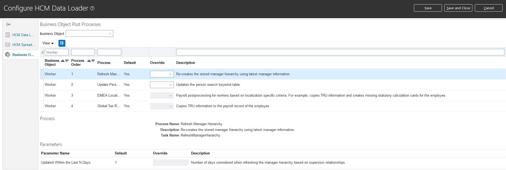

The Business Object Post Processes tab on the Configure HCM Data Loader page is used to view and configure automatic submission of all the post processes for the business objects.
In the Setup and Maintenance work area, select Configure HCM Data Loader task in the HCM Data Loader functional area. On the Configure HCM Data Loader page, select the Business Object Post Processes tab.
- You can review the business object post processes available for automated submission by HCM Data Loader.
- For supporting post processes, you can enable or disable the automatic submission for all the data loads for a business object.

- Filter by the desired Business Object.
- Select the post process and review the value under the
Default column.
- The value: Yes, indicates that the post process for the business object will be automatically submitted whenever HCM Data Loader or HCM Spreadsheet Data Loader successfully loads data for it.
- The value: No, indicates that the post process for the business object will never be submitted.
- If the Override column is enabled for the selected post process, you can overwrite the default value by resetting it with the desired option.
- The parameters for the post process appear below the post process list for the business object.
- If the Override column is enabled for the parameters, you can overwrite the default value and redefine it with the desired value.
