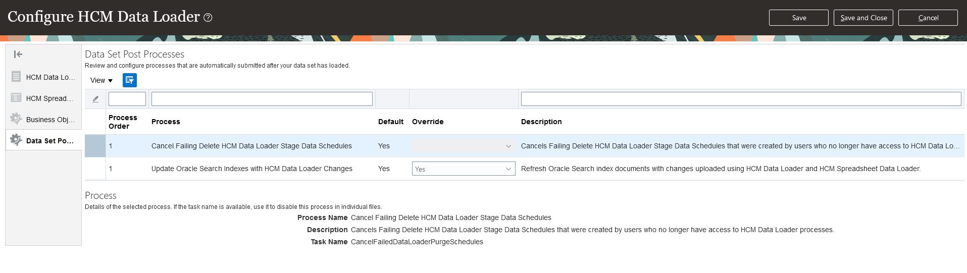

Use the Data Set Post Processes tab on the Configure HCM Data Loader to review and configure automatic submission of the data set level post processes.
Configuring Automatic Submission of Post Processes for Data Sets
In the Setup and Maintenance work
area:
- Select Configure HCM Data Loader task in the HCM Data Loader functional area.
- On the Configure HCM Data Loader page, select the Data Set Post Processes tab.
- Review the data set post processes available for automated submission by HCM Data Loader.
- For supporting data set post processes, enable or disable the automatic submission.

To manage the automatic submission of post process for data sets, in the
Data Set Post Processes page: Select the post process and
review the value under the Default column.| Name | Description |
Process Name |
Name of the data set post process. |
Description |
Describes the function of the data set post process. |
Task Name |
Name of the task for the data set post process. Use this to disable the process for a specific file. |
- The value: Yes, indicates that the data set post process will be automatically submitted whenever HCM Data Loader or HCM Spreadsheet Data Loader successfully loads data for it.
- The value: No, indicates that the data set post process will never be submitted.
- If the Override column is enabled for the selected post process, you can overwrite the default value by resetting it with the desired option.
