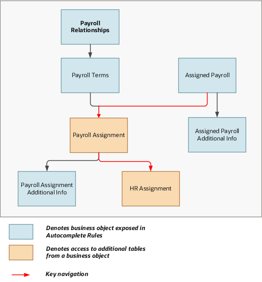

As shown in the figure, the Assigned Payroll object is a part of Payroll and closely linked to the When and Why object.

To navigate to the Payroll Assignments business object traversing row variable on Get Payroll Assignments. For example, to navigate to HR assignment, first you get a handle to Payroll Assignments. |
