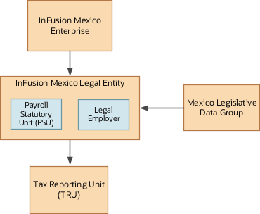

Single Payroll Statutory Unit with Single Legal Employer and Single Tax Reporting Unit
Let's look at an example of the basic model for setting up a single location organization. InFusion Mexico is a registered legal entity, which is both a payroll statutory unit (PSU) and a legal employer.
Set up this model with these basic steps:
  1. Create a Mexican enterprise in the Enterprise Structures Configurator. The Enterprise classification represents the top most structure of the organization.
  2. Use the Functional Setup Manager to create a Mexican Legislative Data Group.
  3. In the Setup and Maintenance area, go here:
    • Offering: Workforce Deployment
    • Functional Area: Legal Structures
    • Task: Define Enterprise Structures for Human Capital Management
Expand the task to display a set of related tasks. Use the Legal Entities task to create a legal entity. You can define it as a legal employer and a PSU, or as a legal employer with another PSU from the list of values. When you define the legal entity, enter the registration information.
A legal reporting unit (LRU) is created automatically when a legal entity is created. In HCM payroll, it's referred as a tax reporting unit (TRU). Enter the LRU information. Set the Legal Reporting Unit Classification to Tax Reporting Unit on the Legal Reporting Unit HCM Information page.
This figure shows a simple organization structure for Mexico

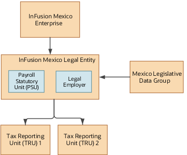

Single Payroll Statutory Unit with Single Legal Employer and Multiple Tax Reporting Units
This example illustrates the basic model for setting up a single location organization with multiple TRUs. InFusion Mexico is a registered legal entity which is both a PSU and a legal employer.
The setup procedure for this model is the same as shown above, except that you create an additional TRU under the PSU. Use the Legal Reporting Unit task to create a new LRU associated with the main legal entity. Enter the necessary details for the new LRU.
This figure shows an organization structure for Mexico having a single PSU with a single Legal Employer and multiple TRUs.
Single PSU, single legal employer and multiple TRUs.
