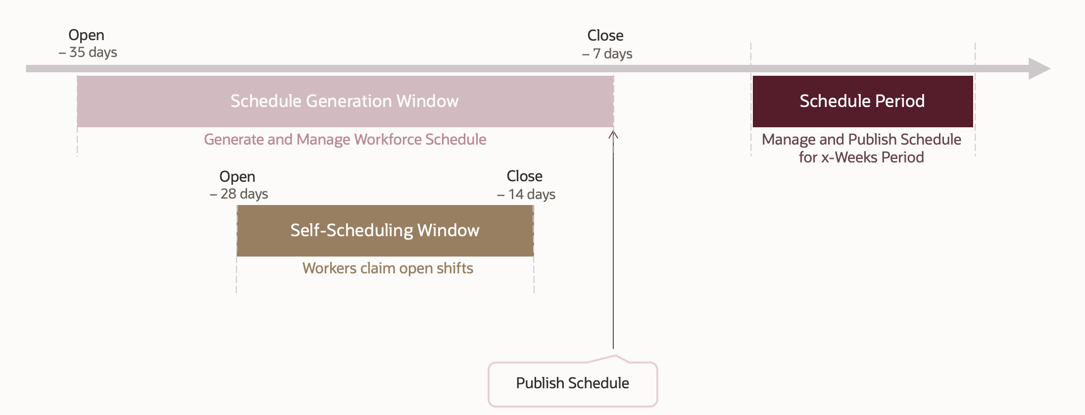

Scheduling Windows
You define the schedule generation window and the optional self-scheduling window contained within it. Schedule managers start working on their schedules when the schedule generation window opens. They publish the schedules to their workers after the self-scheduling window officially closes, if defined, and before the schedule generation window closes. Workers can claim open shifts during the self-scheduling window, and scheduling managers can assign the requested shifts.
You define the schedule generation window and optional self-scheduling window by specifying how many days before the schedule period starts to open and close each window. For example, you create a profile with these windows:
- The schedule generation window opens 90 days before the schedule period starts. And the window closes 30 days before the schedule period starts.
- The self-scheduling window opens 60 days before the schedule period opens. And the window closes 45 days before the schedule period starts. The self-scheduling window start and end dates need to be inside the schedule generation window start and end dates.
