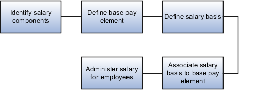

Managing salary involves these steps
Managing salary involves identifying salary components, defining base pay element, defining salary basis, associating salary basis to base pay element, and administering salary for employees.
