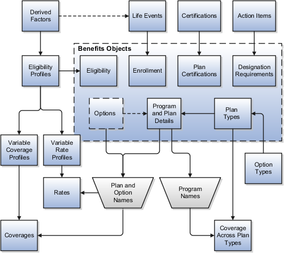

You typically set up several prerequisite or optional components that you add or associate with plans or programs during implementation and maintenance. You can create these components or edit existing components at any time in the Setup and Maintenance and Plan Configuration work areas.
Because you use some components while defining other components, set up preliminary components first as illustrated in this list:
Enrollment action items
Derived factors
Life events
Eligibility profiles
Variable rate profiles and variable coverage profiles
Standard rates and coverages
Variable rates and coverages

Derived Factors
You can use:
Any of the available derived factors as decision criteria in participant eligibility profiles
The Age derived factor in dependent eligibility profiles
Create and edit derived factors using the Manage Derived Factors task.

Eligibility Profiles
Administer policies regarding who can participate in benefits offerings by attaching participant and dependent eligibility profiles at the appropriate level of the benefits object hierarchy. Create and edit eligibility profiles using the Manage Eligibility Profiles task.
You must associate one eligibility profile with each variable rate profile and variable coverage profile.
You can associate multiple eligibility profiles with most objects.
You can associate dependent eligibility profiles with only plan types and plans in program. You can associate only one eligibility profile with each variable rate profile and variable coverage profile.
Variable Rate Profiles and Variable Coverage Profiles
You can associate one or more variable rate profiles and variable coverage profiles with standard rates and coverage, respectively. Use the tasks described in the following table.
Task |
Description |
Manage Benefit Plan Coverage |
Create and edit variable coverage profiles and associate them with standard coverage. |
Manage Benefit Rates |
Create and edit variable rate profiles and associate them with standard rates. |
Standard Rates and Coverage
You attach standard rates to a benefits object to specify the monetary contributions and distributions that the employee and employer make.
When a participant enrolls in a plan, participation evaluation processing enters the calculated result on a payroll element for the employee.
Informational rates, which you typically use for additional reporting, don't use payroll elements.
Create and edit:
Standard rates using the Manage Benefit Rates task
Coverage using the Manage Benefit Plan Coverage task
Variable Rates and Coverage
Associate variable:
Rate profiles with standard rates to create variable rates
Coverage profiles with standard coverage to create variable coverage
