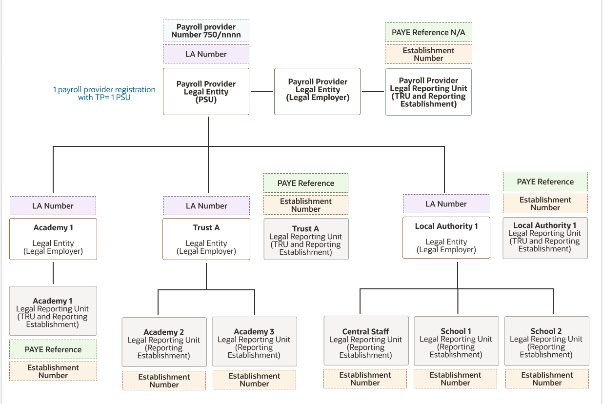

Payroll Provider
Record the Payroll Provider Number at PSU level and a Local Authority number at PSU
level (for example, you could just enter 750). You’ll select both the Payroll
Provider Number and the Local Authority Number in the submission flow parameters,
but the Local Authority Number won’t be reported in the MCR output (assuming you
have no employees attached to the main reporting establishment.)

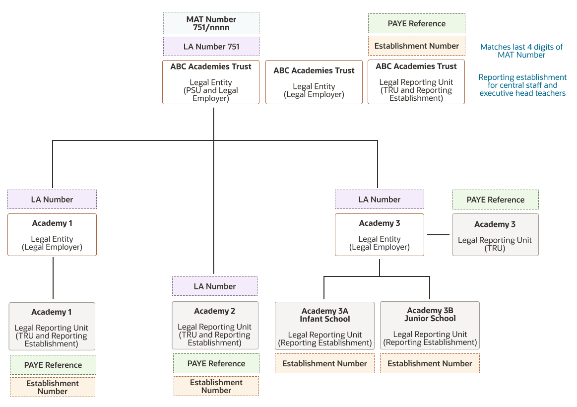

Multi-Academy Trust (MAT)
Record the MAT registration number at PSU level and Local Authority Number 751 at PSU
level. The central staff and executive head teachers are reported against the Local
Authority Number 751 and the Establishment Number recorded on the main reporting
establishment for the MAT. Academy-based staff are reported against the academy’s LA
Number level.

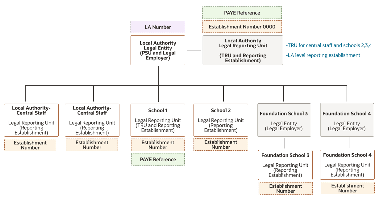

Local Authority Model
In the example shown below, the Local Authority Number is recorded at PSU-level only;
it is reported for all central staff and those working in schools or academies
within the local authority.

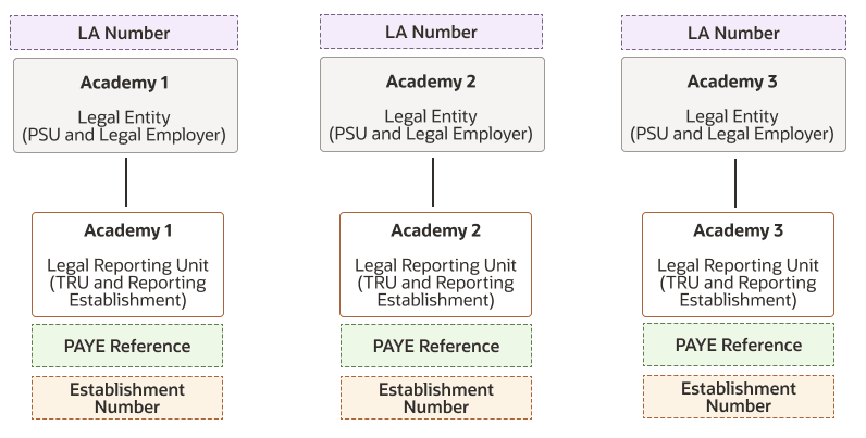

Academies
In this (non-MAT) academies model, each academy is a separate PSU and legal
employer.
