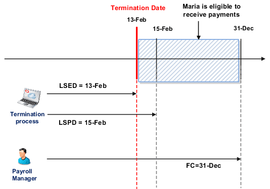

On 13-Feb-2019, Maria Peterson who's on weekly payroll terminates her service with your company. The termination process automatically sets these process dates:
The last standard earnings date to 13-Feb-19.
The last standard process date to the end date of her weekly payroll, which is 15-Feb-19.
However, Maria is still eligible to receive outstanding overtime and commission payments, which can be paid up to 6 months in arrears. To ensure that she's paid these payments, you can update the final close date on the assignment record to 31-Dec-19.
As this image shows, the termination process sets the process dates for Maria.
         In this dat file, you update the final close date to 31-Dec-2019.
