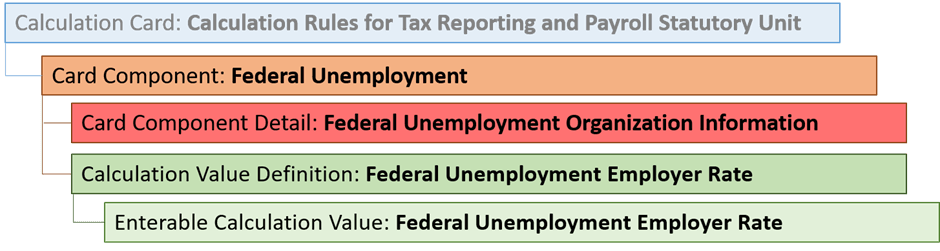

Federal Unemployment Card Component Hierarchy
The Federal Unemployment card component has this shape:
The Federal Unemployment card component uses the Federal Unemployment Organization Information flexfield context and data for this is loaded using the Component Detail record type. It has one override, which is supplied using the Calculation Value Definition and Enterable Calculation Value record types.
Refer to Guidelines for Loading Calculation Rules for Tax Reporting and Payroll Statutory Unit Cards topic for the attributes to supply for each of these record types.
