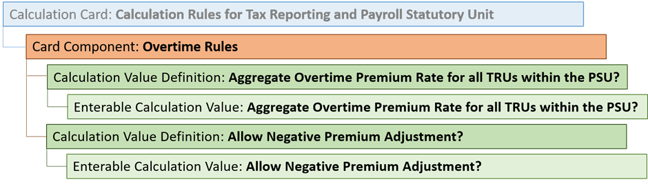

Overtime Rules Card Component Hierarchy
The Overtime Rules card component has this shape:
The Overtime Rules card component uses value definitions to capture override values. Value definitions are supplied using the Calculation Value Definition and Enterable Calculation Value record types.
