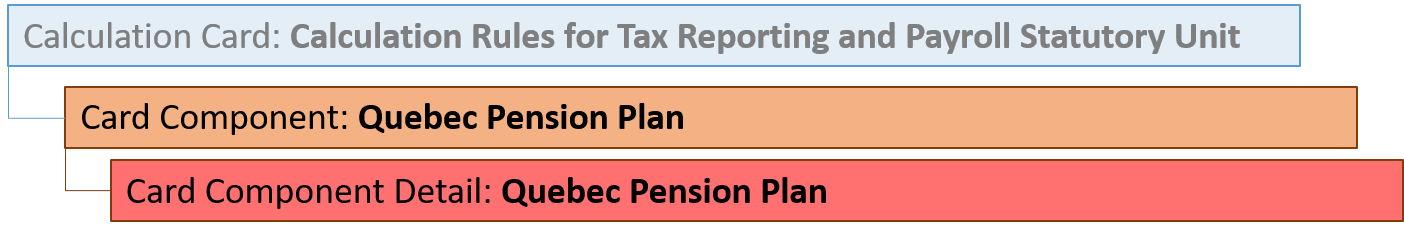

Quebec Pension Plan Card Component Hierarchy
The Quebec Pension Plan card component has this shape:
The Quebec Pension Plan card component uses the Quebec Pension Plan flexfield context and data for this is loaded using the Component Detail record type.
