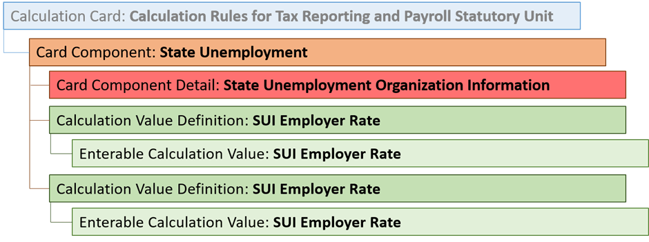

State Unemployment Card Component Hierarchy
The State Unemployment card component has this shape:
The State Unemployment card component uses the State Unemployment Organization Information flexfield context and data for this is loaded using the Component Detail record type. You provide overrides for the value definitions using the Calculation Value Definition and Enterable Calculation Value record types.
