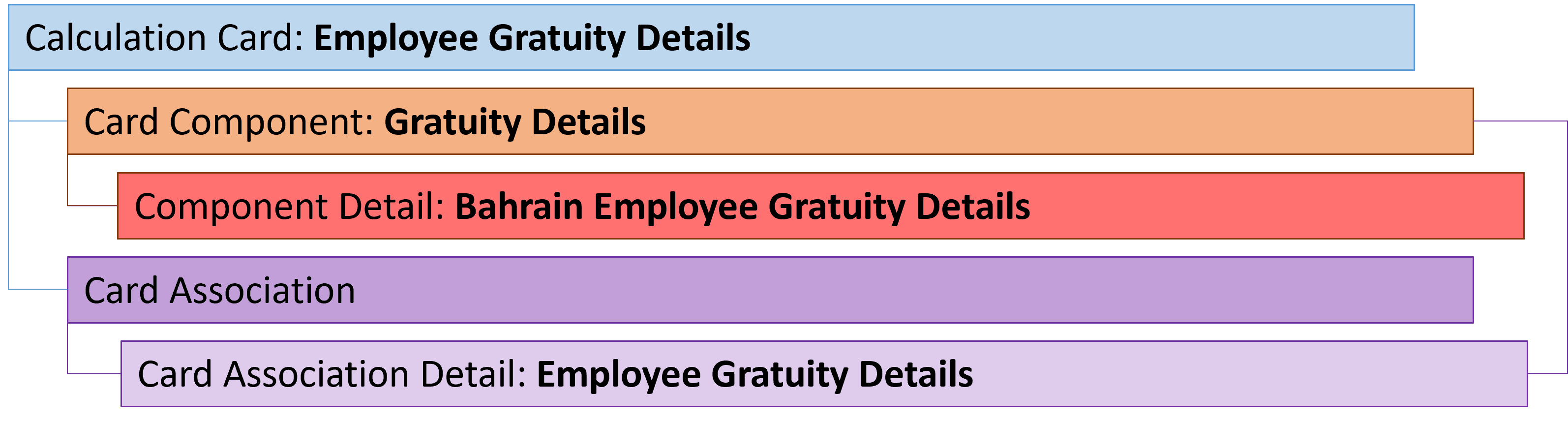

Employee Gratuity Details Calculation Card Record Types
The Employee Gratuity Details card is uploaded with HCM Data Loader using the Global Payroll Calculation Card business object. This generic object hierarchy provides record types to support the various country-specific requirements.
Component | Functional Description | File Discriminator |
Calculation Card | Defines the calculation card type and the employee assignment that it captures information for. | CalculationCard |
Card Component | Used to group and segregate data required by the calculation card. The following sections describe the card components applicable to this calculation card and the child records that are required for each card component. | CardComponent |
Component Detail | Provide a component detail record for each flexfield context required by each card component. | ComponentDetail |
Card Association | Associates the calculation card with the Tax Reporting Unit the employee reports to. | CardAssociation |
Card Association Detail | Associates card components with the employee’s assignments. | CardAssociationDetails |
Employee Gratuity Details Calculation Card Hierarchy
The hierarchy of calculation card components applicable to Employee Gratuity Details are described in this diagram:
