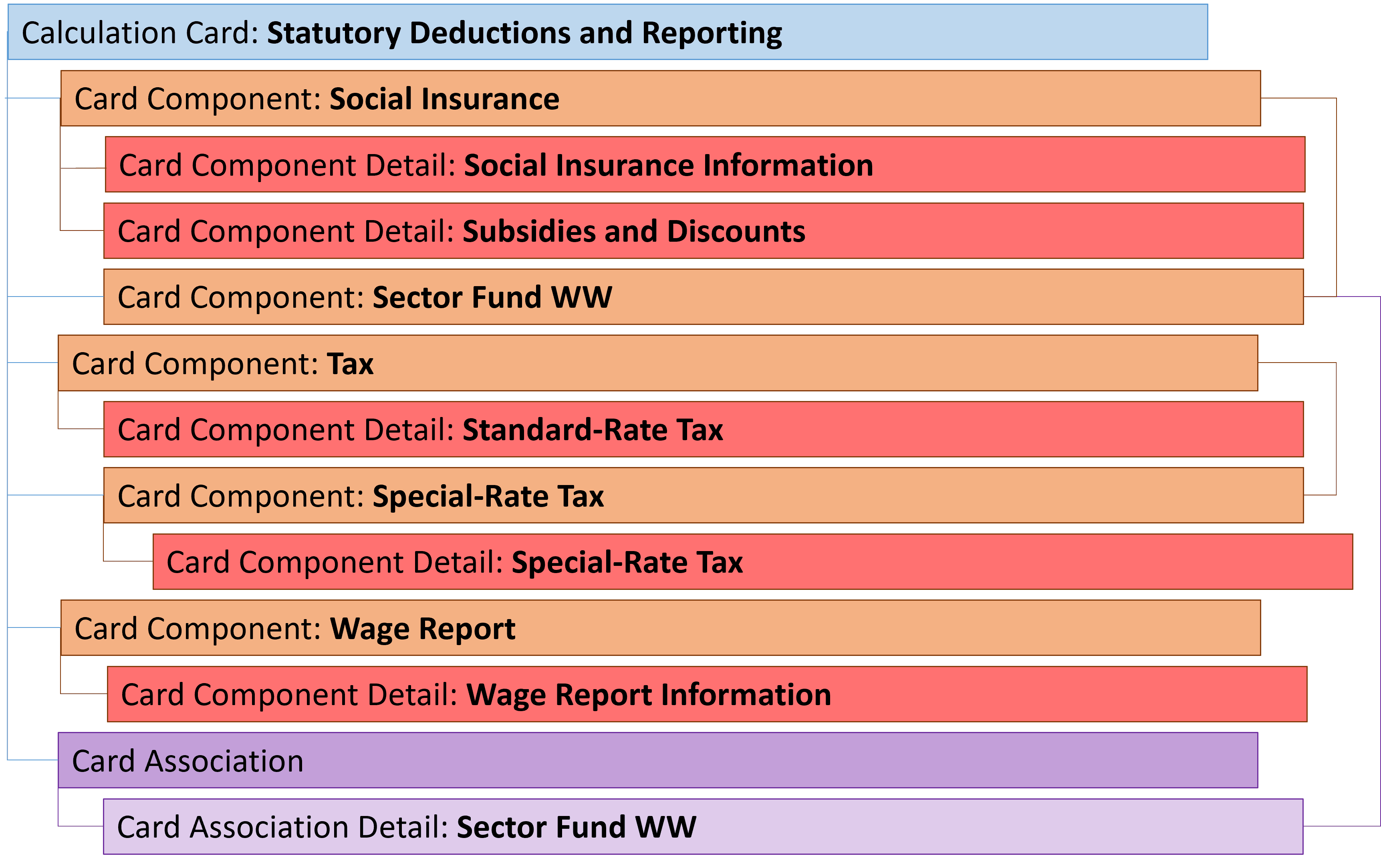

Statutory Deductions and Reporting Calculation Card Hierarchy
The hierarchy of calculation card components applicable Statutory Deductions and Reporting card are described in this diagram:
A separate topic follows to describe how to provide data for the calculation card record and each card component.
