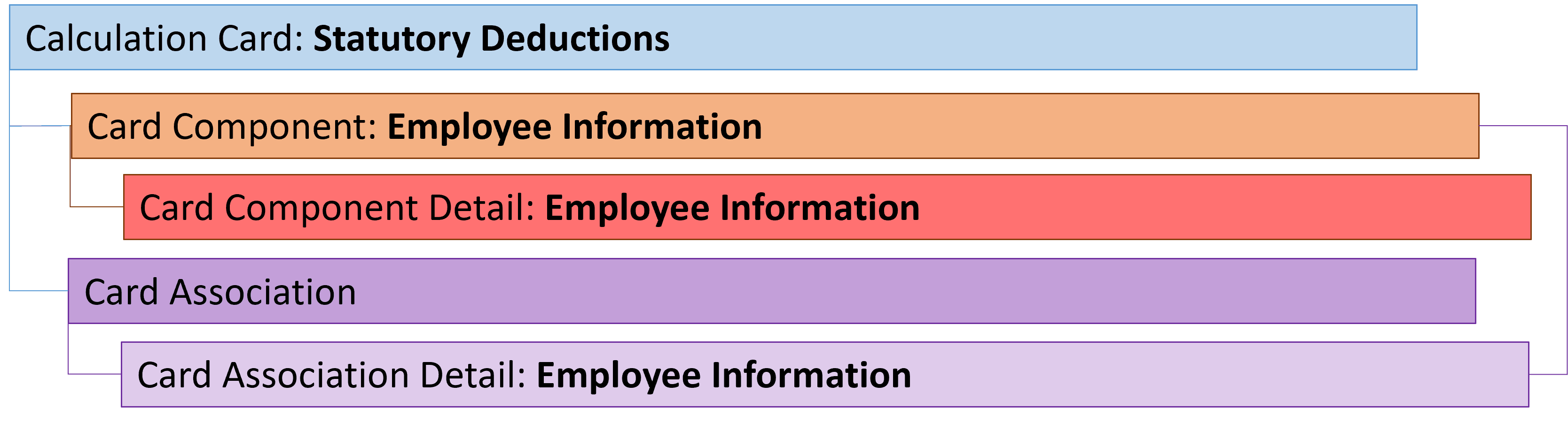

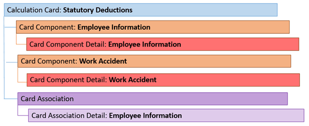

Statutory Deduction Calculation Card Hierarchy
The hierarchy of calculation card components applicable Statutory Deductions are described in this diagram:
