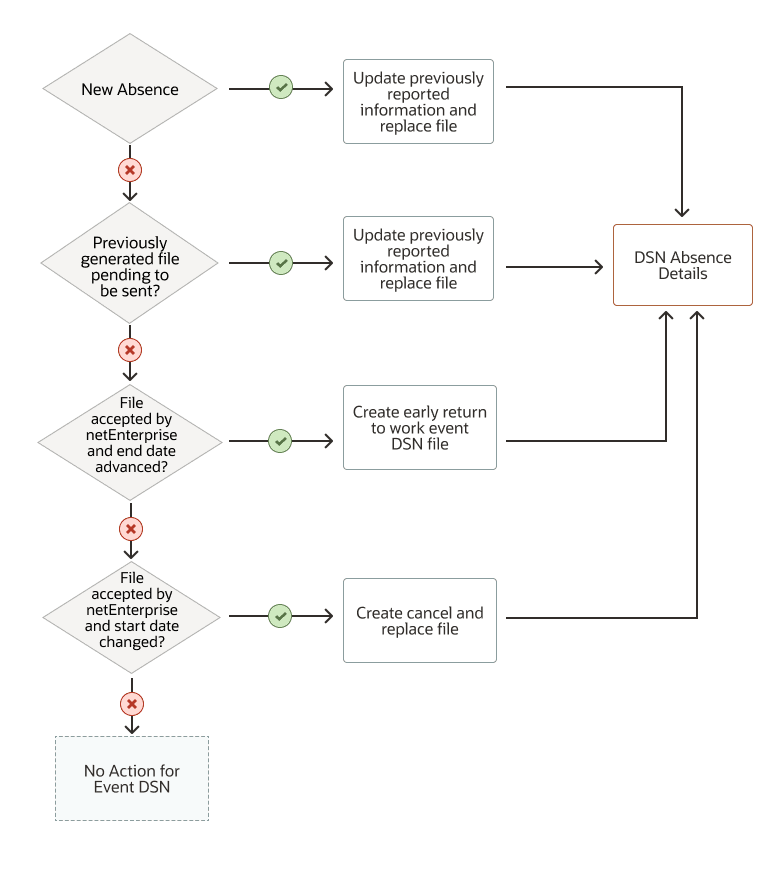

The type of actions that are supported are:
  • Generation of file upon first time entry of the absence event.
  • Generation of a Cancel and Replace event DSN for change of start date.
  • Generation of a Cancel and Replace event DSN for change of subrogation dates.
  • Generation of an Early Return to Work file in case the absence end date is advanced.

The ESS process will read the absence changes comparing to the previous submission and will prepare the reporting information for next submission. This process reads the changes in the absences and store the information to be reported after analyzing the previous submission status, acceptance status of previous status. The flow ‘Absence Event DSN’ will then trigger DSN validations as per 2025 DSN Specs and generate the files.
