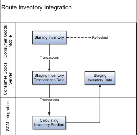

Here's how this integration works when using the Maintaining Static Inventory Position method of calculating the inventory level:
  1. The SCM system recalculates inventory using the Maintaining Static Inventory Position method and sends the updated records to the consumer goods server.
  2. The CX Retail Execution Mobile retrieves the refreshed inventory records from the consumer goods server to update the inventory position for the next route execution.
  3. CX Retail Execution Mobile sends transaction records created during route execution to the consumer goods server.
  4. The consumer goods server prepares the transactions records and makes them available to the integrating SCM system.
The following graphic shows the integration flow:
Route inventory integration flow
In this integration, the mobile application calculates the inventory position as follows:
  1. Reads the route-inventory level and the Last Processed Transaction Time Stamp from the Route Inventory staging table.
  2. Reads all transactions later than the Last Processed Transaction Time Stamp. See, Integration Tables and Key Fields.
  3. Adds the transaction quantity of each transaction to the original product inventory level.
The inventory position thus calculated by the mobile application is temporary and isn't sent to the consumer goods server. The inventory transactions that remove items are in the negative and those that add items are in the positive.
