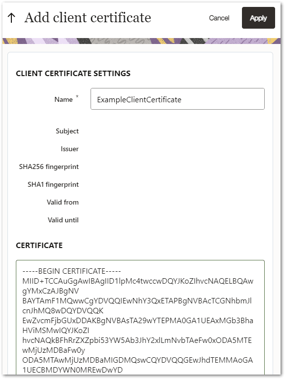

  3. Click Create. The Add client certificate page opens.
  4. In the Name field, enter a name for the new certificate.
  5. In the Certificate field, paste the certificate and private key data in the format:
    -----BEGIN CERTIFICATE-----
    <certificate content>
    -----END CERTIFICATE-----
    -----BEGIN PRIVATE KEY-----
    <private key content>
    -----END PRIVATE KEY-----
    The Add Client Certificate window from the Connections tab on Intelligent Advisor Hub
    Note that:
    • There may be one or more certificates associated with a single private key.
    • A client certificate must be in PEM (Privacy-Enhanced Mail) format, with the private key in unencrypted form, before it can be pasted into the Certificate field. To convert a certificate in PKCS12 format into PEM format, see Convert a client certificate.
  6. Click Apply. The details from the certificate you provided are extracted and shown in the CLIENT CERTIFICATE SETTINGS panel.
    The Client Certificate Settings for a client certificate in Intelligent Advisor Hub.
