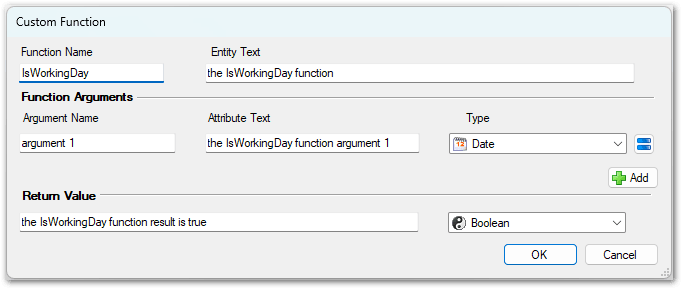

For example, if we had an IsWorkingDay custom function defined in Policy Modeling:
The Custom Function dialog in Policy Modeling showing an IsWorkingDay custom function definition
