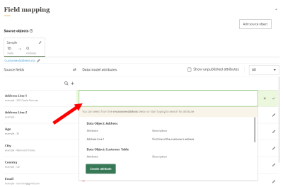

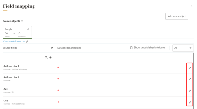

To map source object fields to data model attributes:
  1. For the source field that stores email data, click Edit An image of the edit button. Use it to complete field mapping for ingestion jobs. .
  2. Click the pencil icon to start adding attributes
  3. Select or search for the HashedEmail attribute created previously.
  4. An image showing recommended attributes and the search field
  5. To add the attribute, click the Checkmark An image of the checkmark button. Use it to confirm field mapping for ingestion jobs..
  6. Add a transformation to the attribute by clicking Transform.
  7. An image showing the data transformation link
  8. Select a Hash transformation.
  9. Make the following configurations for the hash transformation.
    • Select SHA-256.
    • Make sure that the checkbox for Convert to lowercase is checked.
  10. Continue following the steps for configuring additional field mappings and managing source fields.
