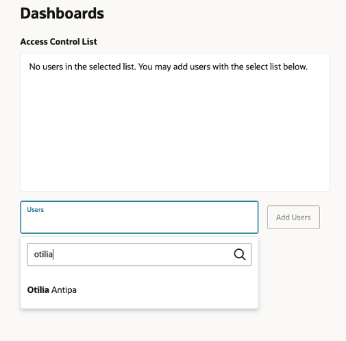

- To grant access to a user, click
Add users/roles and complete the dialog. Use the Set Permission to drop-down list to set the appropriate permissions.
Tip: If you want to customize the permissions, select Custom from the Set Permissions to drop-down list. After you return to the Permissions window, click
Edit custom permissions to customize the permissions.
- In the Permissions window, if available, specify how the permissions are to be applied using these options: Apply permissions to sub-folders and Apply permissions to items within a folder check boxes.
