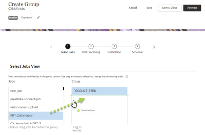

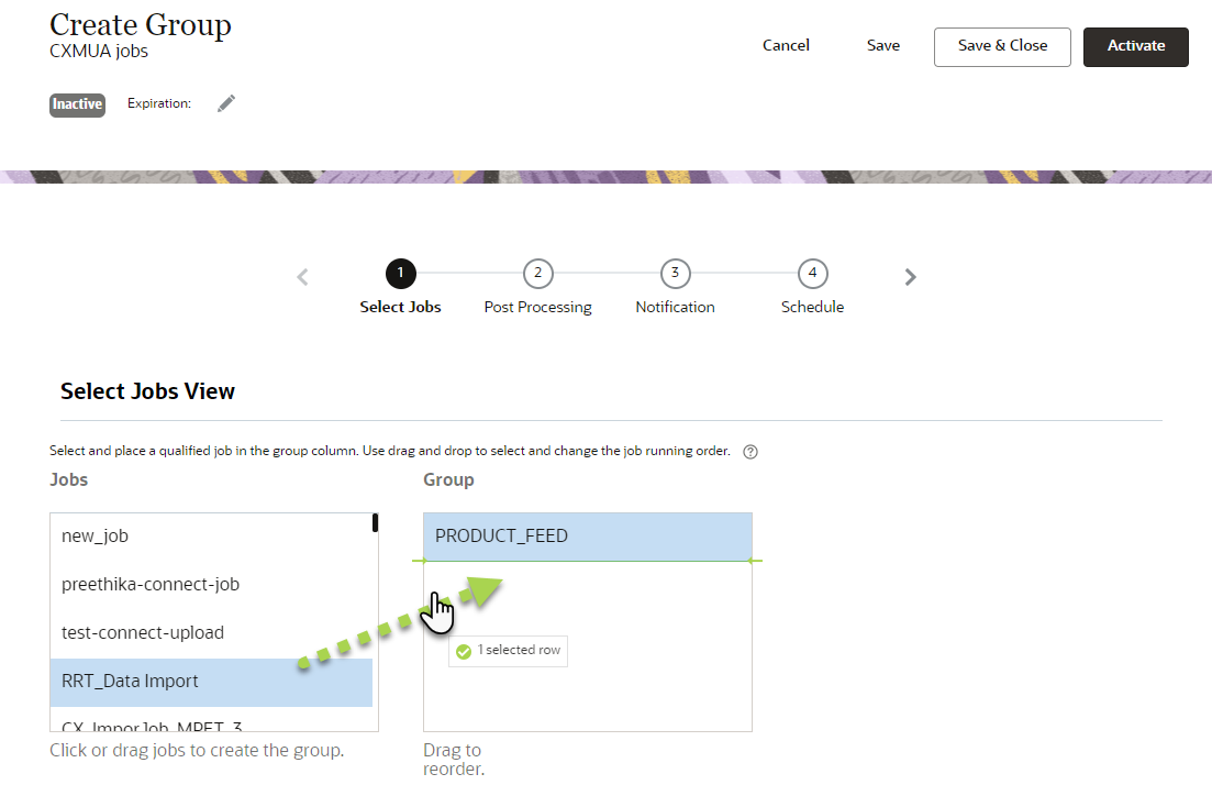

    Screenshot of the Connect Create Group page.
  5. On Step 1, select the jobs that you want to include in the group from the Jobs list and move them to the Group list.
  6. After you have jobs in the Group list, arrange the jobs in the order you want them to run.

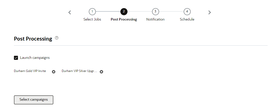

  7. On Step 2, to launch campaigns at the end of a successful group run, click the Launch campaigns check box. Click Select Campaigns to choose the campaigns.
    An image showing post processing selections for a Connect Group
    Note: If you choose a campaign that has an automatic launch, the campaign is launched on schedule regardless of whether the group run has finished.

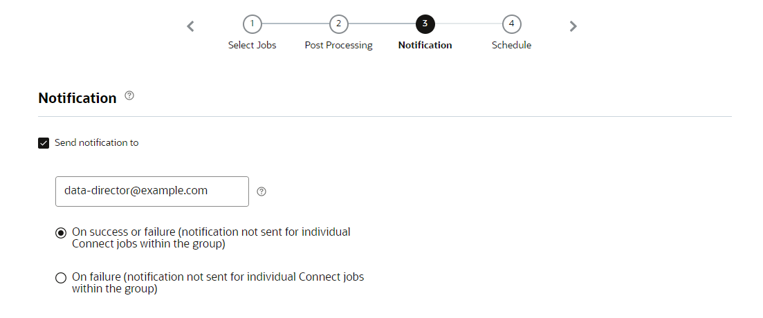

  8. On Step 3, set up email notifications for the group. You can choose to send notifications after the success or failure of a job. Notifications are only sent after all jobs in the group complete.
    Screenshot of the Notification step of creating a Connect job group.

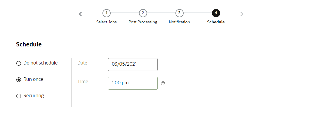

  9. On Step 4, complete the schedule for the group.
    When setting the start time of a job, select one of four time slots within the hour: 0-14, 15-29, 30-44, 45-59. For each scheduled job, the system picks a random minute (for example, 12 within the 0-14 segment). This distributes the start times of jobs more evenly.
    Screenshot of the Schedule step of setting up a Connect job group.
    The job will start at random times within the chosen time slot. Setting up a new job in a slot that overlaps with the current time might produce that states that the time selected occurs in the past. Therefore, as best practice, choose the time slot that is after the current time slot.
