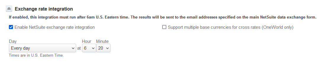

Import exchange rates from NetSuite into SuiteProjects Pro daily, weekly, semimonthly or monthly, so the exchange rates in SuiteProjects Pro are the same as in NetSuite on the import date. To do so, check the Enable NetSuite exchange rate integration, and set the Day and time (Hour and Minute).
The import time should be 10-20 minutes after the exchange rate are updated in NetSuite to ensure that exchange rates match between the two systems.

Note:To maximize the amount of time in the day when foreign currency exchange rates in SuiteProjects Pro and NetSuite match, you should do both of the following:
In NetSuite, set the Update Time Zone to U.S. Eastern Time (UTC-5) on the base currency record.
On the NetSuite Connector Administration form, under the Exchange rate integration section, set the import day and time to every day 10-20 minutes after 6 a.m..
If you select a different Update Time Zone on the base currency record in NetSuite, adjust the import time accordingly. Note that by doing so, the amount of time in the day when foreign currency exchange rates in SuiteProjects Pro and NetSuite match will be smaller.
