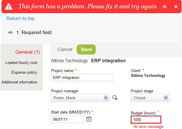

This example displays the error message 'An error message' next to the budget_time field.
NSOA.form.error('budget_time', "An error message");The message appears as a system-generated error.

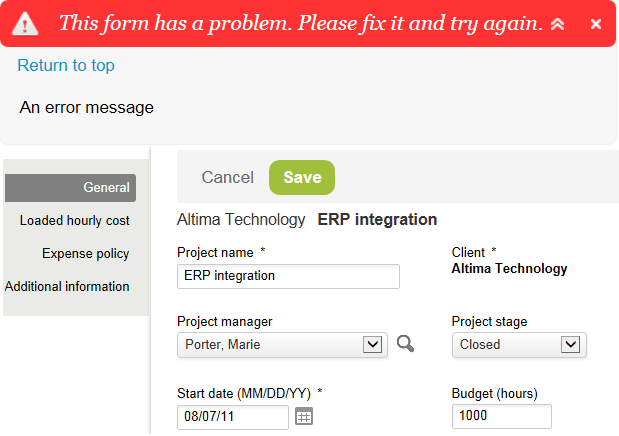

This example displays the error message 'An error message' at the top of the form.
NSOA.form.error('', "An error message");The message appears as a system-generated error.
