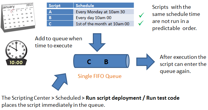

Scheduled scripts are created in a similar same way to form scripts and follow the same scripting workflow. The main differences are that scheduled scripts are not associated with a form, have higher Scripting Governance limits, and are executed according to a schedule defined when they are deployed.
Scripts are executed one at a time from a single first in first out (FIFO) queue.
See Creating Scheduled Scripts.
Two or more scripts with the same schedules times that need to run in a specific order should be merged into a single script, that is merge into one script with one Entrance Function calling each of the three functions in the desired order.
