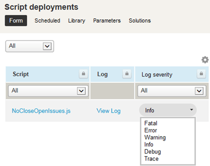

Administrators can control the messages that are written to deployed scripts by setting the Log Severity for the script.

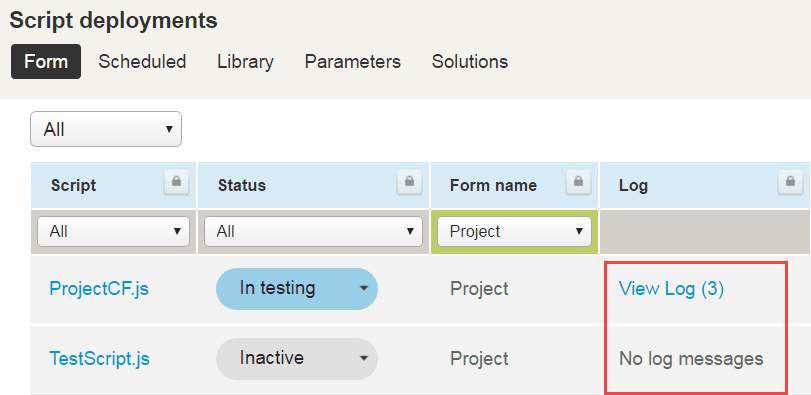

You can see how many log entries are part of a log without having to open each log with the “Display the number of logs at 'View logs' link” feature. This feature shows a count of log entries as part of the "View Log" link for Form and Scheduled Script Deployments.

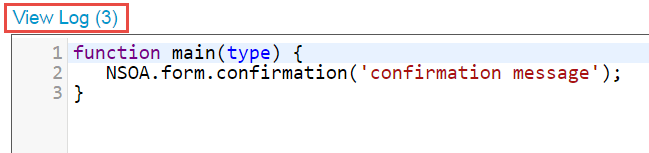

The number of logs also appears next to the "View Log" link in the Scripting Editor.
To use this feature, go to the User Menu > Personal settings > Scripting Studio Options and select the "Display the number of logs at 'View logs' link" option.

The default Log severity level for deployed scripts is "Error". This means that only "Error” and "Fatal" severities are written to log. In this case "Trace", "Debug", “Info”, and “Warning” messages are simply ignored.
Administrators can set the Log severity level for deployed scripts.
"Fatal" and system generated messages are ALWAYS logged! A system Info message is written to the log when the log severity is changed.
You can set the log severity to "Warning" or "Error" to save space and improve system performance for scripts that are operating correctly and generating log information that you are sure you don’t need.
You can set the log severity of a deployed script to "Debug" to track down errors that only occur for a deployed script.

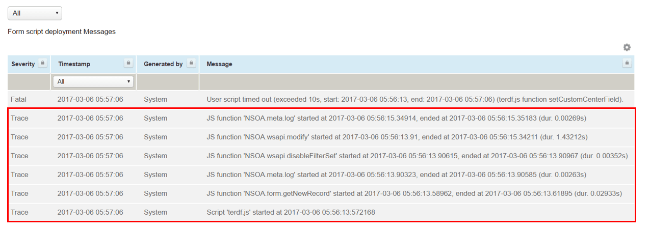

Trace Level Logs
Fatal "User script timed out" log messages are followed by "Trace" log messages which break down the time used in the script to assist you in identifying the root cause of the time out. The log messages indicate the time taken by each function call in the script.

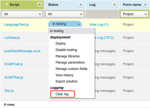

Clear Log Entries for a Specific Script
You can clear all log entries for a specific script from the Scripting Center.
To clear log entries for a script
Go to Administration > Scripting Center.
Click the status dropdown for the script in the Status column, then click Clear log.
A confirmation dialog appears.
Click OK to clear the logs.
If there were any log messages to be cleared, the log now contains a single entry indicating that the log was cleared manually.

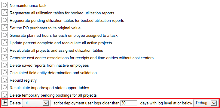

Delete Log Entries
The delete log entries maintenance task is available to allow administrators to delete log entries that are no longer needed. This can be useful to save space and create smaller backup files.
The delete logs task is available from Administration > Global Settings > Account > Maintenance Settings.
Use this maintenance task when your system is not busy and ensure not to delete log entries that you may need.
You should keep at least the last 30 days of log.
