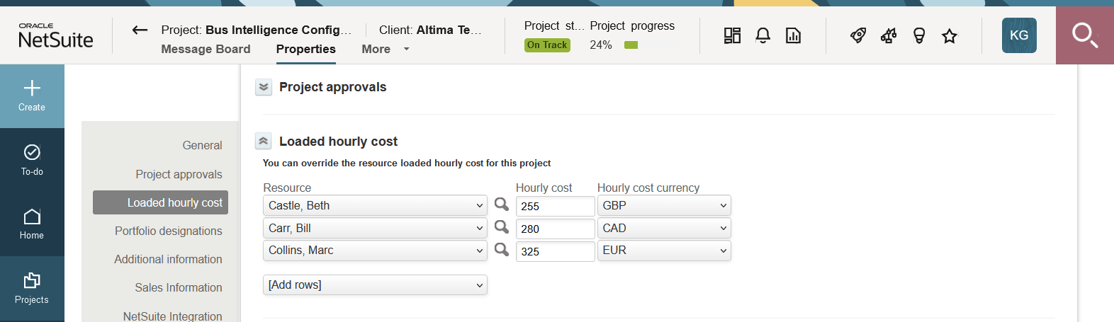

You can accurately report on a project's profitability based on a user's loaded cost value in SuiteProjects Pro. Because a user's cost value may vary based on the project or task being worked on, loaded cost overrides can be established at the project or task level. Currently, when overriding the cost at the project or task level, the currency of the cost value is driven by the project's currency. At times, it may be beneficial for the currency of the user's cost value override to be different than the project's currency.
SuiteProjects Pro enables you to override the currency value for loaded cost overrides at the project and task levels. This permits more accurate profitability reporting based on the loaded cost currency on a per-project or per-task basis. The default setting for the currency value is set to "[Use Project Currency]" unless modified to a different selection. However, please note that if the project's currency changes, it does not dynamically update the currency value to the project's new currency.
