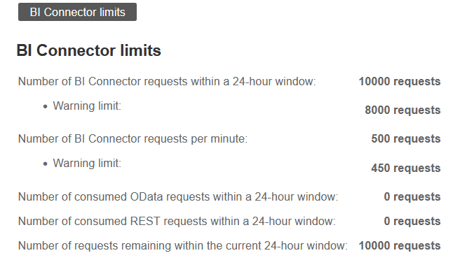

  • Administrators and users with the View BI Connector limits role permission can view BI Connector limits and usage for your company's SuiteProjects Pro account on the BI Connector limits (Administration > Global Settings > Account > BI Connector limits). The BI Connector limits page shows the maximum number of requests allowed for your account as well as the number of requests remaining in the current 24-hour window. It also breaks down the number of requests consumed using the OData service and the REST API in the current 24-hour window.
    OData limits page in the Administration module
