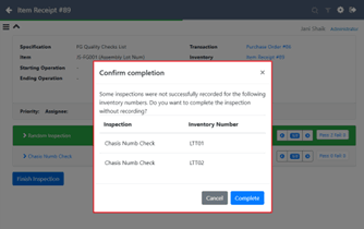

Alert on Missing Inspections for Lot and Serial Items
To keep data accurate and compliant, the SuiteApp automatically alerts Quality Engineers if any lot or serial number is missing an inspection. This alert helps engineers finish all required entries before they complete the inspection process.
On the QM tablet, if you select an inspection queue and click Finish Inspection, you'll see an alert with a list of missed inspections for the lots or serials.
