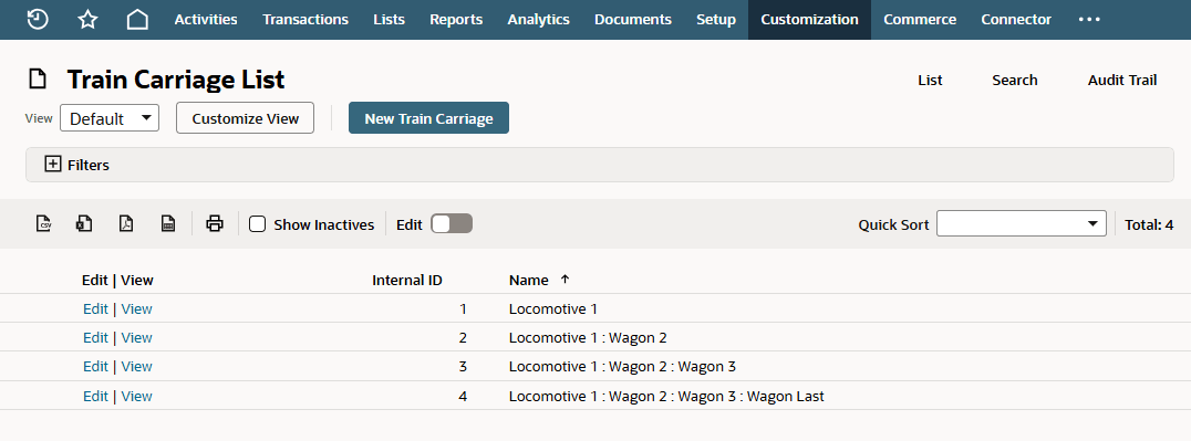

Creating the Record Instances
For this example, assume your company has multiple locomotives, each with associated wagons. The following steps create record instances for one locomotive and its wagons.
To create the record instances:
From the Record Types page, locate Train Carriage and click New Record.
In the Name field, enter Locomotive 1 (the parent record).
Leave the Parent field blank.
Click Save & New.
In the Name field, enter Wagon 2 (the first child record instance).
In the Parent field, select Locomotive 1.
Click Save & New.
In the Name field, enter Wagon 3 (the second child record instance).
In the Parent field, select Locomotive 1 : Wagon 2.
Click Save & New.
In the Name field, enter Wagon Last (the final child record).
In the Parent field, select Locomotive 1 : Wagon 2 : Wagon 3.
Click Save.
The final list of record instances looks like this:

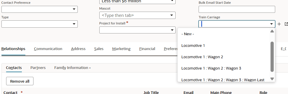

Go to Customization > Lists, Records, & Fields > Entity Fields > New.
In the Label field, enter Train Carriage.
In the Type field, select List/Record.
In the List/Record field, select Train Carriage.
On the Applies To subtab, select where the field should apply. For this example, check Customer and Project.
Click the Display subtab.
In the Subtab field, select where you want the field to appear. For this example, select Main.
Click Save.
You can now add this field to your forms as needed. For more information, see Configuring Fields or Screens.
The field on a form looks similar to this:
