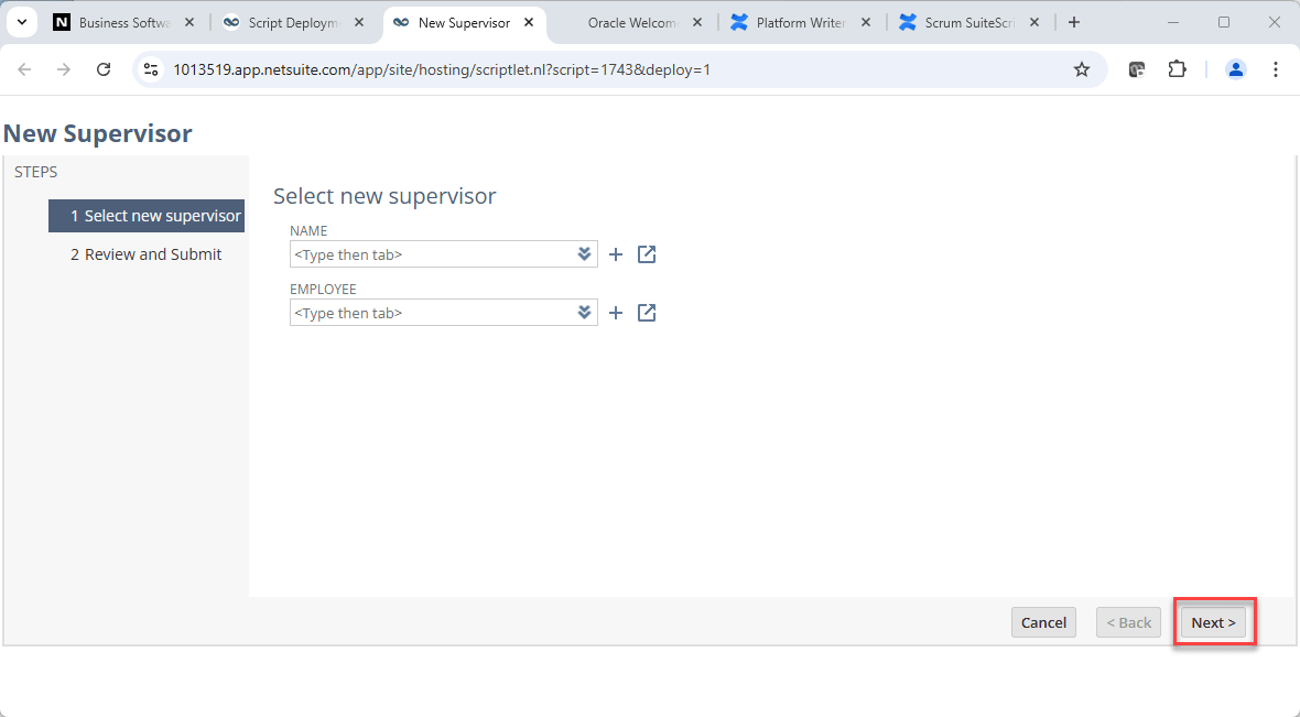

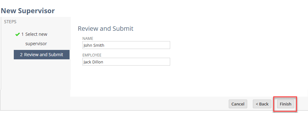

The following screenshots show the output of the sample custom assistant script in this help topic.
Step 1 of sample custom assistant Step 2 of sample custom assistant

The following sample creates an assistant with two steps. In the first one, you can select a new supervisor for the employee selected. The second step displays the selection and submits it.
