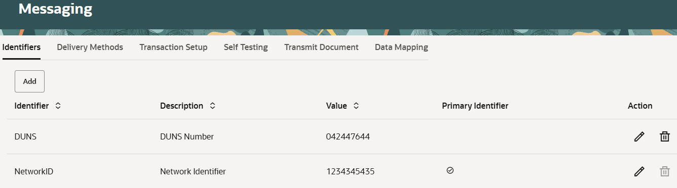

Defining Identifier for your Company
Log in to your OBN account.
At the bottom of the page, click the Messaging tab.
Click Add to open the Add Identifier window.
In the Identifier Type field, select an identifier type.
Enter an identifier value.
Click Add.
To set an identifier as primary:
Click Edit next to the identifier that you want to set as primary.
Check the Mark as Primary? box.
Click Update.

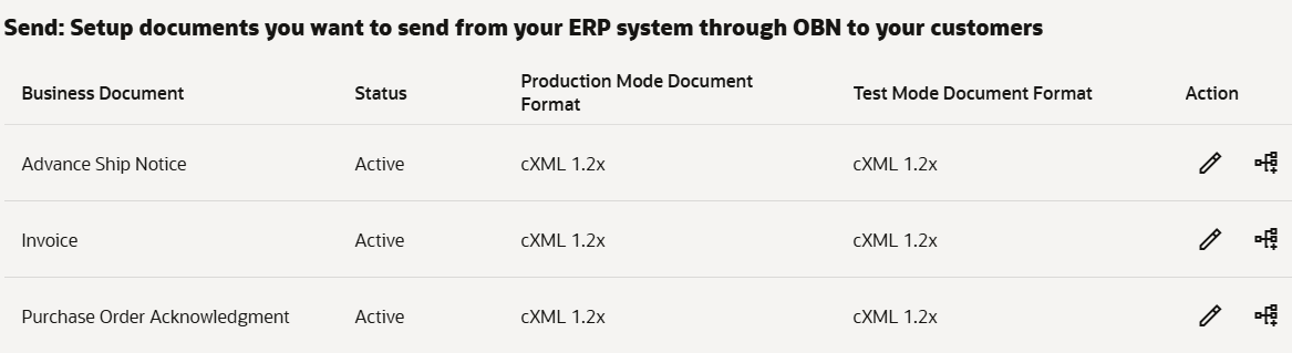

To activate the transactions:
At the top of the page, click the Transaction Setup tab.
Under the Send: Setup documents you want to send from your ERP system through OBN to your customers section, edit the following business documents:
Advance Ship Notice
Invoice
Purchase Order Acknowledgement
In the Add Business Document popup window, complete the following:
In the Status field, select Active.
Under Document Format, in the Production Mode and Test Mode fields, select cXML 1.2x.
Click Add.

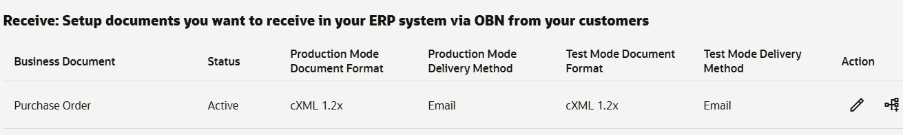

To transmit documents from your server to OBN, under the Receive: Setup documents you want to receive in your ERP system through OBN from your customers section, edit Purchase Order.
Under Production mode, complete the following fields:
In the Document Format field, select cXML 1.2x.
In the Delivery Method Name field, select a value.
Under Test Mode, complete the following fields:
Click Update.
