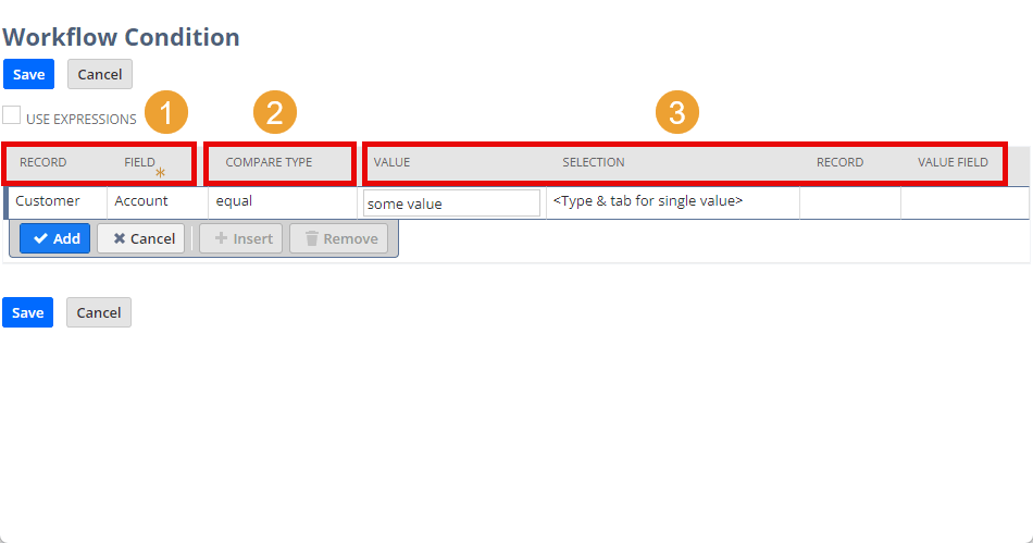

Each condition you define with the Condition Builder consists of three main parts:
  1. Target value for the comparison (left side of the condition). Use the left Record (optional) and Field columns to choose the field to compare.
  2. The comparison operator.
  3. Value used to compare against the target value (right side of the condition). You can't combine multiple values from different columns in one condition. If you want to use more than one value columns in a condition, combine the conditions using expressions. For more information, see Complex conditions.
A screen capture of the Condition Builder.
